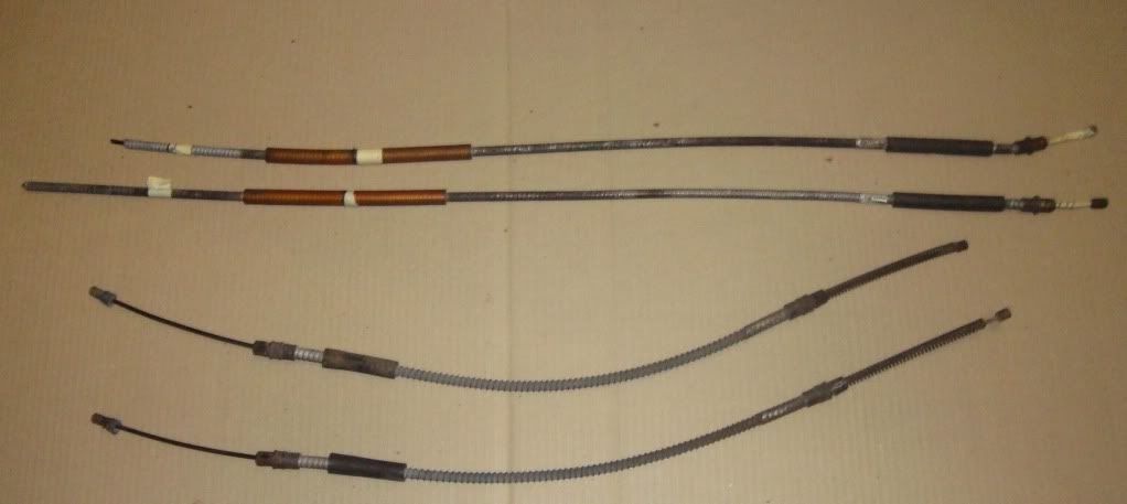

Well guys, I am to big to fit under the drivers side to remove the entire ebrake cable to swap in the 87-88 ebrake cable, plus it takes welding and other brain damage to make it work. I came up with my own easy solution.

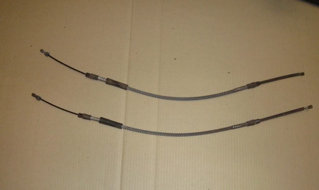

I removed the 86 TC ebrake cables from door back to drums.It is held together with just a simple clip.
Then I cut the old cables from the 87-88 rear and put them in place and measured them to the existing ebrake cables and brackets on my 86 TC.
http://i158.photobucket.com/albums/t97/biggrgivens/Custom%20E%20brake%20cables/86vs87ebrakecables.jpg

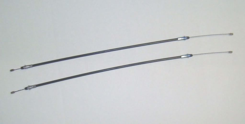

Then I brought them in for the cable guy to create them using the design of the 86 cable and the measurements I took with the 87-88 cable.
Wallah! new ebrake cable for use on my 86 TC that now has disc brakes!!
