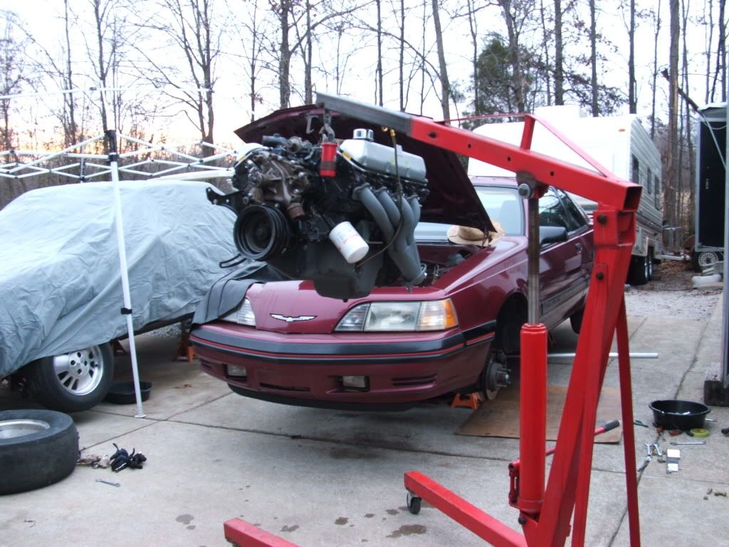

Well, last night I pulled the 730 lb. 460 engine out of my 87 TC. It was originally built for my 84 Crew Cab, but I was using the TC to break in the engine. It's broke in now. Plus, I broke the C-6 trans behind that 460 at the dragstrip in October. (driveshaft locks up when the trans goes into 2nd)
So here I am with a rolling chassis, but I have to make a decision on which engine will go in the car. No more big blocks...that phase has run it's course.
I am really excited about the new 5.0 Coyote engines in the 2011 Mustang GTs. Everything I have read about that engine is impressive. I would love to own a 2011 GT or the new 2011 F-150 shortbed 2wd with the 5.0C, but the cost is more than I am comfortable with.
I would probably run a C-4 trans, and since my TC has manual steering and brakes, that should help the install. I really do not want to go to an aftermarket k-member. I got the 460 to fit with the original k-member, so I think I would like to see if the Coyote engine will clear the TC k-member as well. Rear gears would be 4.56 and the torque convertor would probably have a 3000 stall rating. I hear those Coyote engines can run up to 7,500 rpm.
The other option is to finish the dream started in 1999 when I bought the car and that was to run the TC in NHRA Stock Eliminator with the 2.3T and a C-4 trans.
For now, I'll put it away for the winter and debate my choices....

out of curiosity what engine mounts did you use to make that work with the stock K member?
MY 87 TC...no more 460 BB....now I can't decide which engine should come next...
Quote from: 88turbo;347837
out of curiosity what engine mounts did you use to make that work with the stock K member?[/QUOTE
The mounts were custom solids designed to fit onto the stock TC pedestals.
I had to put spacers in them when I went to the tubular shorties after the D5 cast iron manifolds were taken off. it was easier with spacers than re-fab another set.
In retrospect, I could have sandwiched rubber in there instead on those large nuts.....LOL

nice mounts! LOL at the rubber statement
