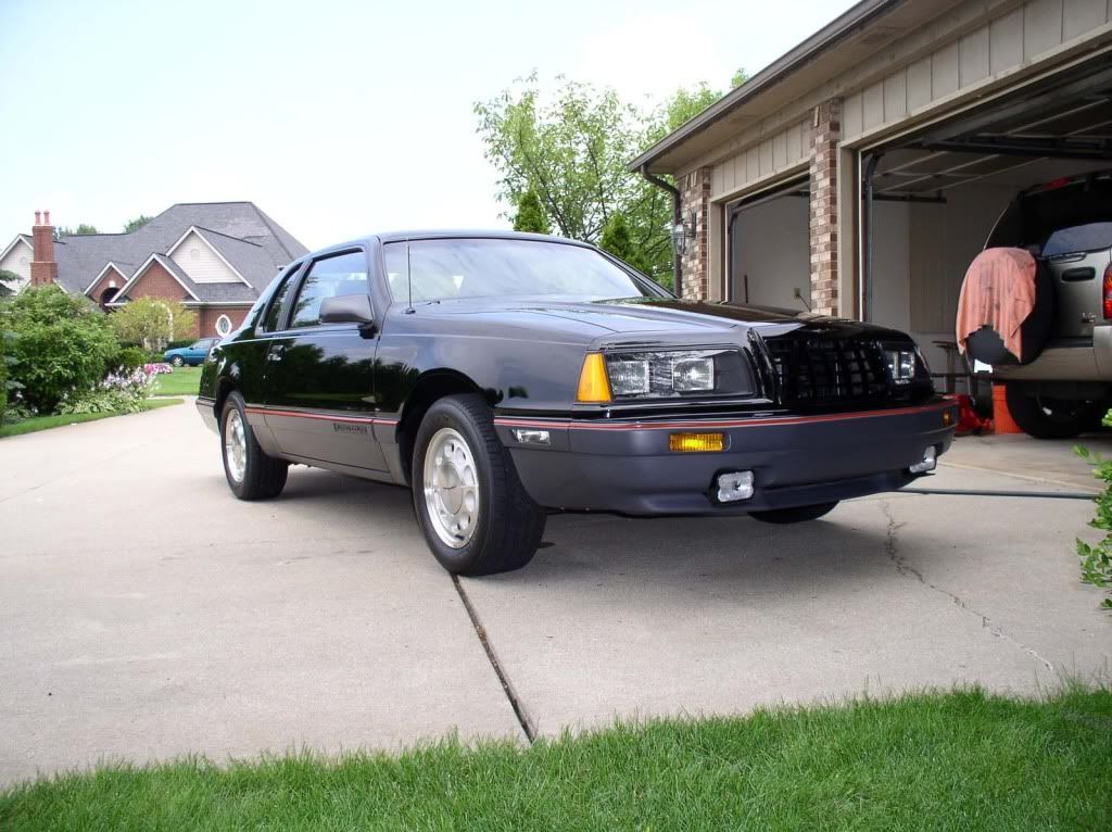

Does anyone know how I can clean up, rather than paint, the lower half of a 86 Turbo TC? It will save me on the paint job, plus it will retain a nice stock look.
I want it to shine like its new
I want it to look like the lower half of this car

why don't you just paint it with duplicolor or something..

SEM trim paint in Charcoal works absolutely fantastic , I re-did the lower portion of my Mark Vii and it came out great and it took less than one can

it would be easier to repaint, then try to restore something that's sun baked

The trim is both rubber and plastic, at least on 87-88. The plastics I have heard you can rub vasiline or petrolium jelley on it to make it alittle bit softer. I'm not sure how you would fix the rubber trim.

My mom has a 01 Jeep Grand Cherokee and the trim around the car became a light grey, so i hit it with a heat gun and it returned the dark grey to the bumper. I dont know if the same can be done to this plastic.
