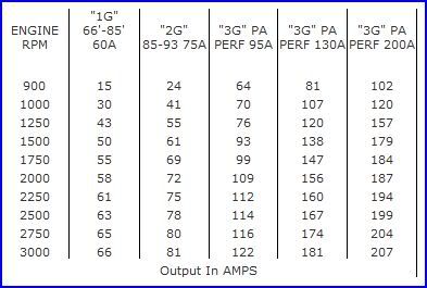

Granted they're $150, but I like the 95A 3G from PA Performance. No bracket mods and I used the original wiring, just changed the connectors to the ones provided with the alternator. 64 A at high idle is more than enough - I see 14V typically. They're guaranteed for life too.
For $40 more you can get it powder coated in a bunch of colors too http://www.jdsperformance.com/index.asp?initemuid=539&fcmd=item&inmake=0
