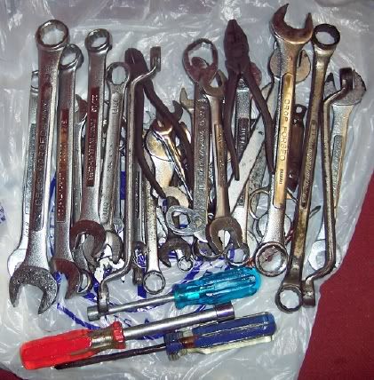

A pile of vintage wrenches/tools i picked up for 0.25ea, BEFORE:

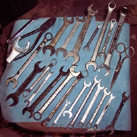

AFTER: (Other rusted tools were added, Not pictured above)

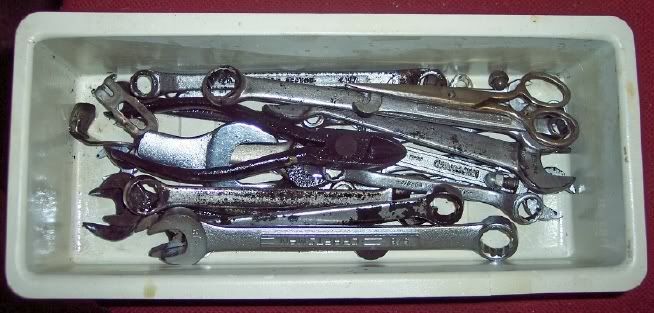

Fresh jug of evaporust, And first round of rusted tools:

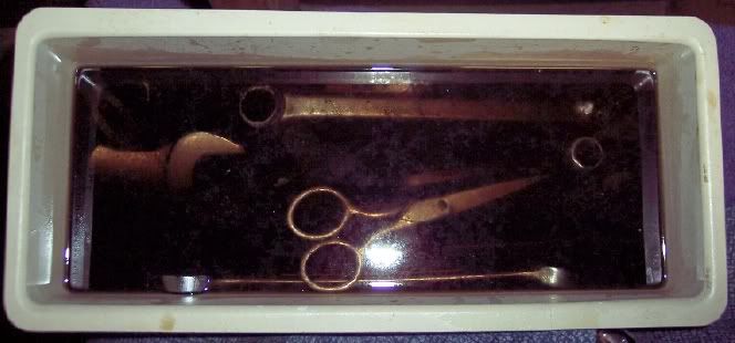

Next day: (Stuff added after previous photo)
Evapo strained and drained, Then tools Rinsed off with water like instructed:
Dried out then whiped/sprayed down with WD-40, And set out to dry:

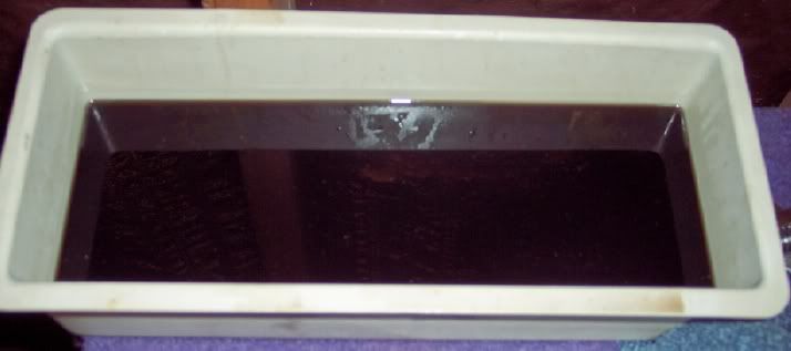

Same chemical used about 5 overnight rounds:
