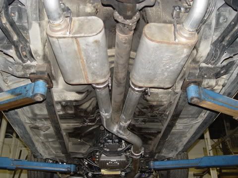

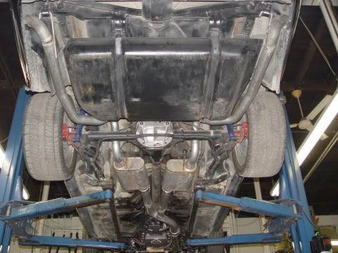

I need some help I need a picture or pictures of anyone here that and has changed or has their car with dual exhaust. I have a 88 Cougar with the 3.8 and I want to put dual exhaust on it and the ler guy I use (which I have used many timed before and am very happy with) says it can not be done?? Anyone with pics I can show him to prove him it can be done.... Or is he right?

Here are some shots of my car as a single turbo but it gives you an ideal of how you can run the exhaust.
 Hope this helps.
 I would get a double hump trans crossmember and run true duals

Thanks 5.8fastcat thats exactly what I was looking for..

 Had to dig thur some old CD's to find that pic. I knew I had 1
