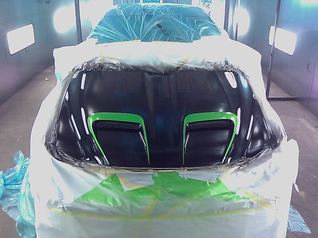

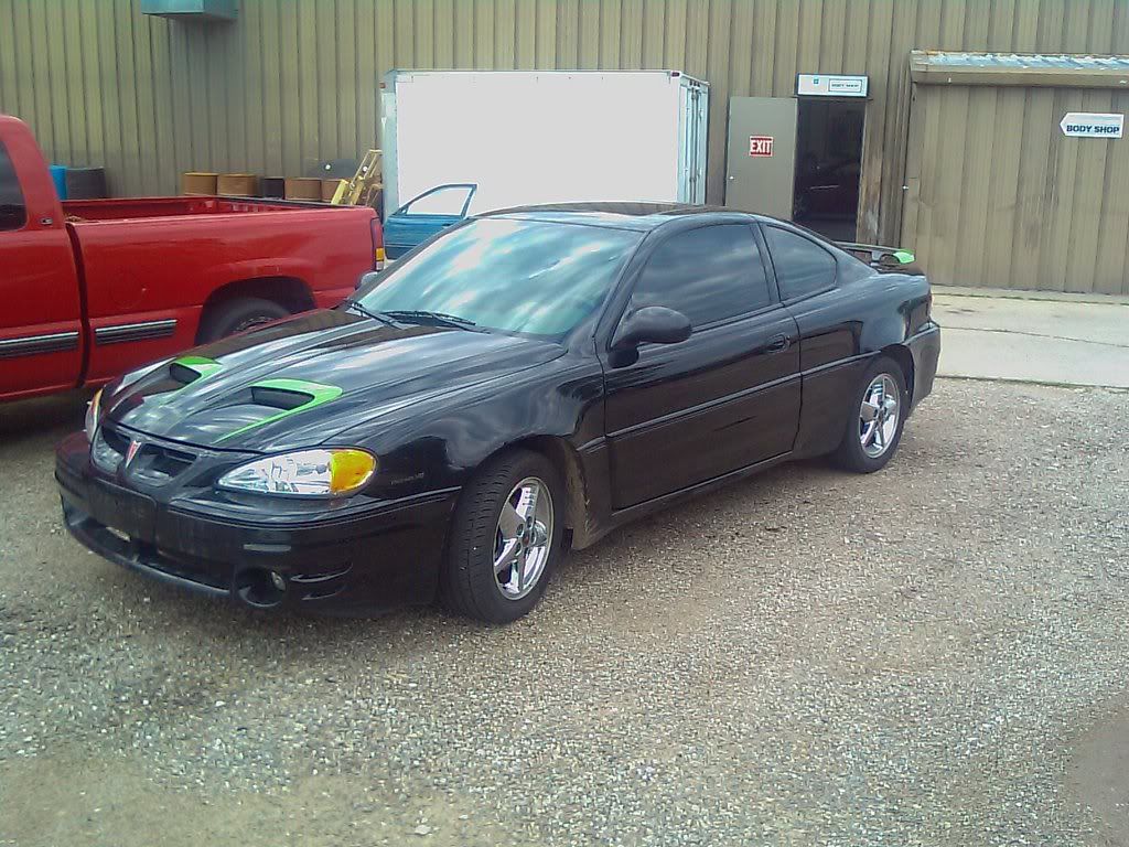

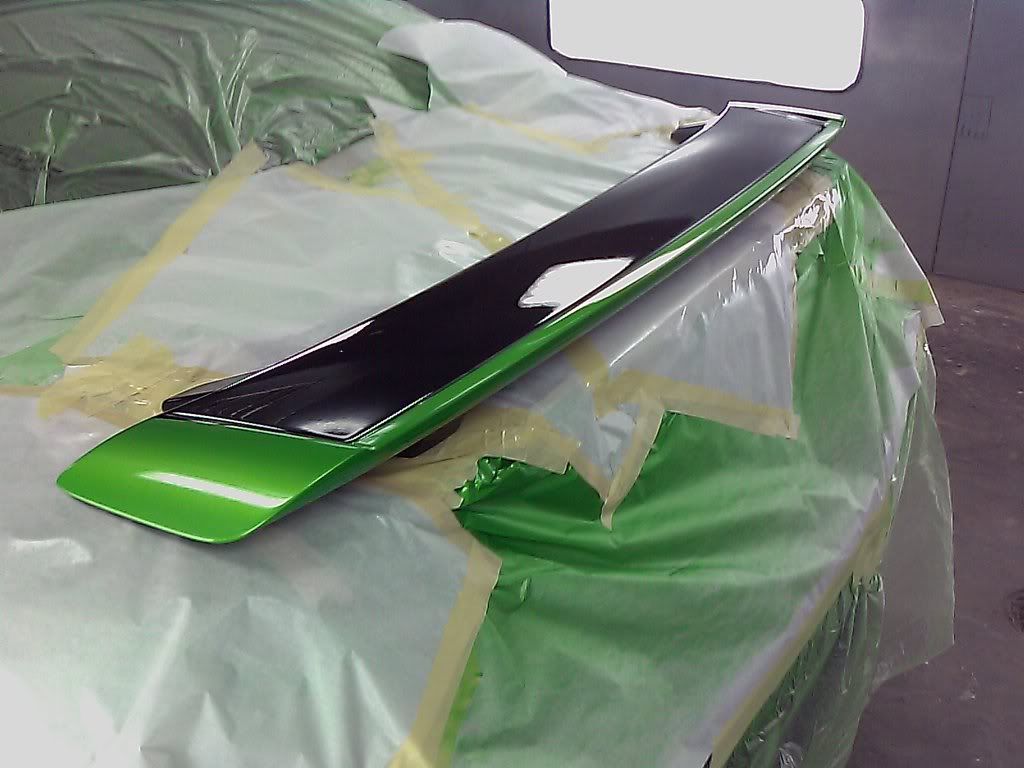

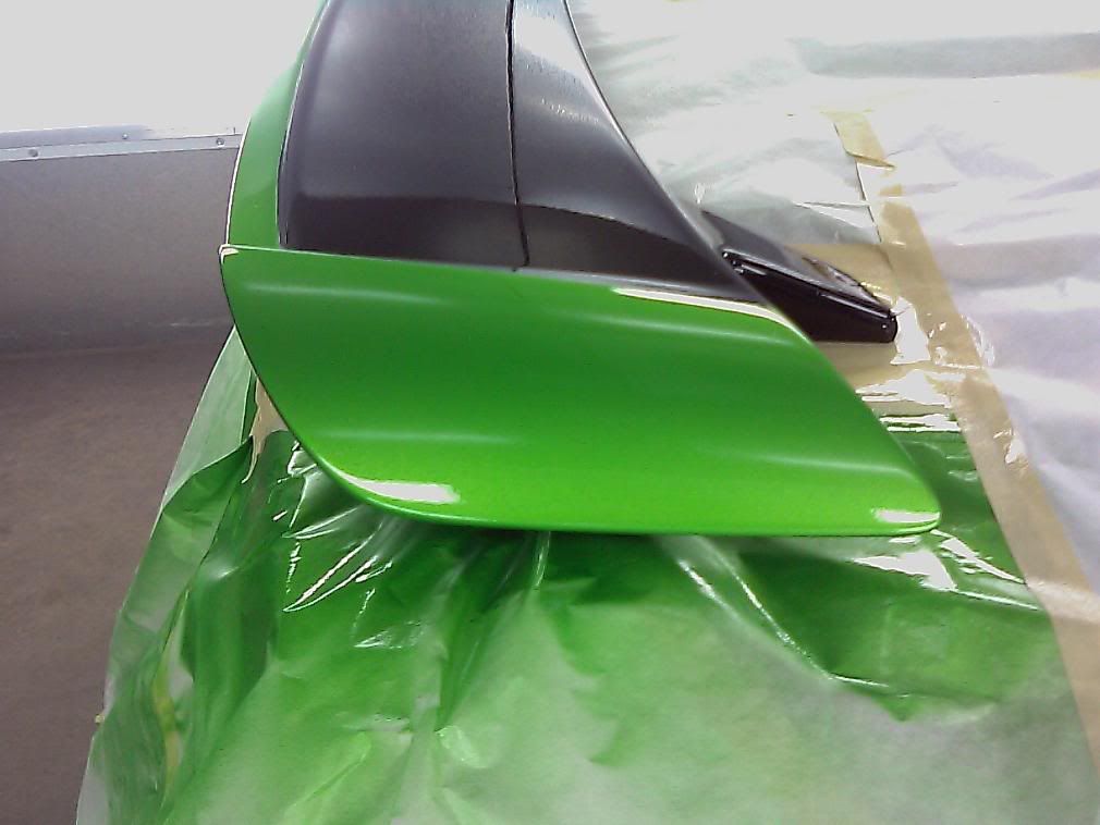

Two weeks ago I decided to actually go through with my plans to paint some accents on my Grand Am SC/T. I love blacked out vehicles but this needed something. I looked through the SIKKENS color chip book picked out a custom color and the closest matching was a Kawasaki color. I mixed the custom color which has less yellow in it thank god and heres the results. Im redoing the back of the spoiler to flow with the lines, and Im gonna do something with the sides(undecided yet). I bought green LED underglow for it, the only non performance mods I will do to any car and its only this one.

Heres my photobucket with the prepping, masking and painting pics. We use SIKKENS paint and I was using a SATA 3000. Scuffed with a Norton 800 grit wet prep pad until clear had no shine left, then cleaned, masked and two light coats of green, then two coats of clear.

BTW your wheel wells are dirty ;)

only thing I would add is the small line that runs across the trim and bumpers, in that green would look killer!

Daboss, Carpimp: The molding stripe I was gonna paint, but not on the bumper just between the wheels. I dont want to do too much to it, just enough to blend the front and back together. Ive been toying with Ideas.
Thunderjet: My whole car is dirty!! I wash it and then what do ya know it RAINS! I hate it, It needs a good cleaning again, but I make sure when its clean, its CLEAN! lol.
