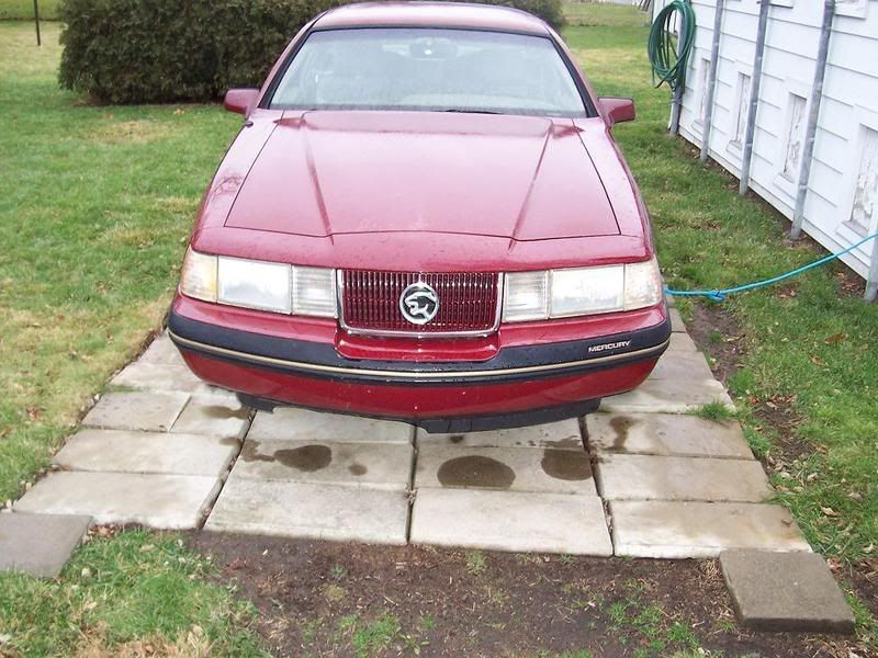

The thread about how much we all enjoy our cars has made me rethink what i have been doing with my 87 as of lately, which is absolutely nothing.
I have a few key points i need to get to fixing
The Cougar as of today

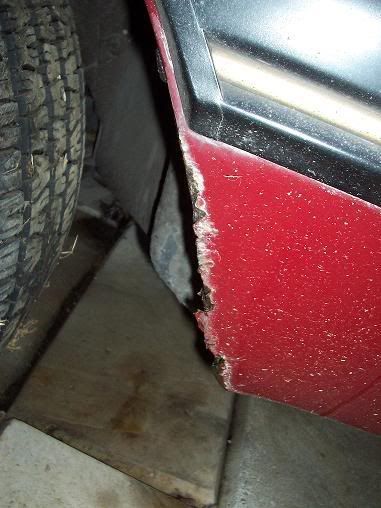

Ouch
Ouch
Triple ouch

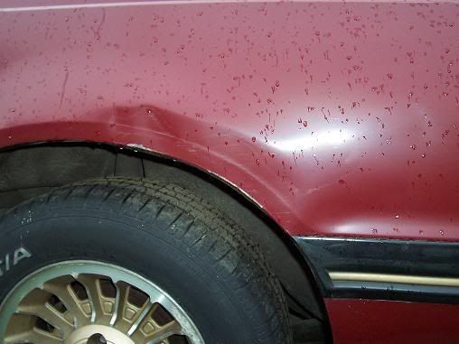

Once i can find another job i MUST start saving to fix this body rot and the dent i put in the overfender. Does any of the aftermarket rust arrester/stopper spray stuff work by the way.

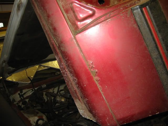

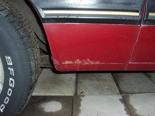

I was in the shop/garage today and decided to snap a pic of the rust creep I was talking about in the last post.
here's a pic thats very common to all our cars
Looks pretty much the same as the pic in the first post.
This one is a little less though.

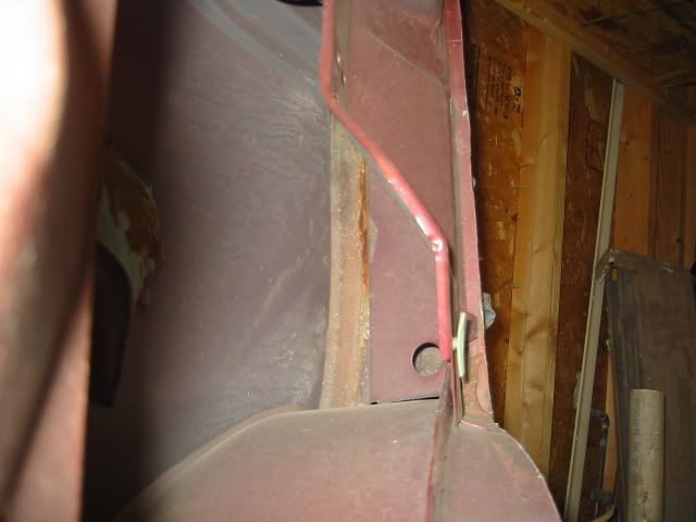

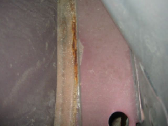

Here's a pic of the inside of that same panel where the seam comes together.
the rust is starting to spread across the inside of the rocker and the  of the quarter.
Here's a close up
If you repair the exterior of this seam without repairing the inside, the car will keep rusting under any filler, caulk/seam sealer and paint.
I would suggest repairing this also. and at least use a rust encapsulating type of product to keep the air and moisture from spreading it. if nothing else.
I did a quick repair on that area about 10 years ago. I got lazy and didn't strip any of the interior. only to find out, that part of the car has rusted away to nothing.
It only takes a 1/2 hour and a TORX 50 (if I remember corectly) to take that panel off completely
I hope this post helps everybody that has rust in this area
