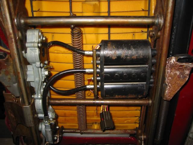

booksix,
Is this what your seats look like?
