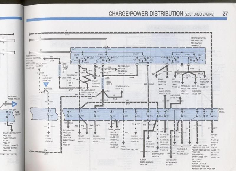

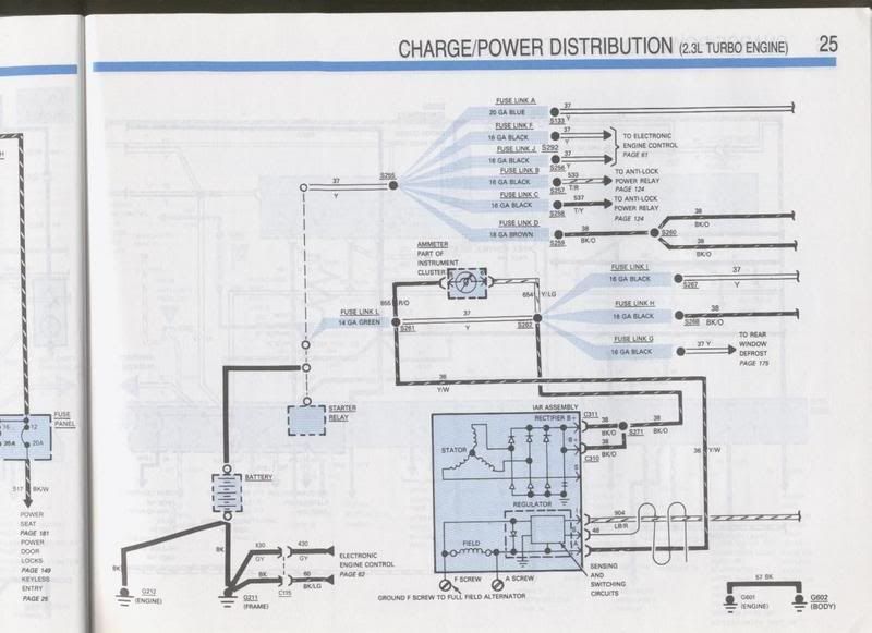

I dont think that is what I am looking for bud if it is I cant read it. any way you could scan it bigger? what year of 2.3T is that for?  I have an internal regulator
Need help once again Solved!!
Thats from the 87' EVTM scott sent me. I'll attach them, thats in my photobucket

According to my diagrams there is no black wire at the alt - there's a black/orange (this is the main output wire and is a large gauge), a yellow/white stripe wire (should have power at all times) and a light green/red wire (should have power when ignition switch is on). This is likely the wire you're referring to (somebody may have replaced the plug).

According to them, the above scans, and my diagrams...
"A" (Yellow/white bottom wire) connects to black/orange's fusible link either directly (alternator warning light cars), or via the ammeter+shunt (gauge cars).
"S" (White/black middle wire) connects to the case, one rectifier diode, and middle of the stator (FFI site), or the case and a floating "shield" wire (above).
"I" (Green/red top wire) connects to the alt light (some cars) or directly to the ignition switch (gauge cars) via fusible link "K" (above).
You should be looking for some humongous short circuit that blew your wire right off the fusible link, or overheated it so much it changed color to black before it finally went. Without that wire, there's no "start-up" current to get the alternator charging.
