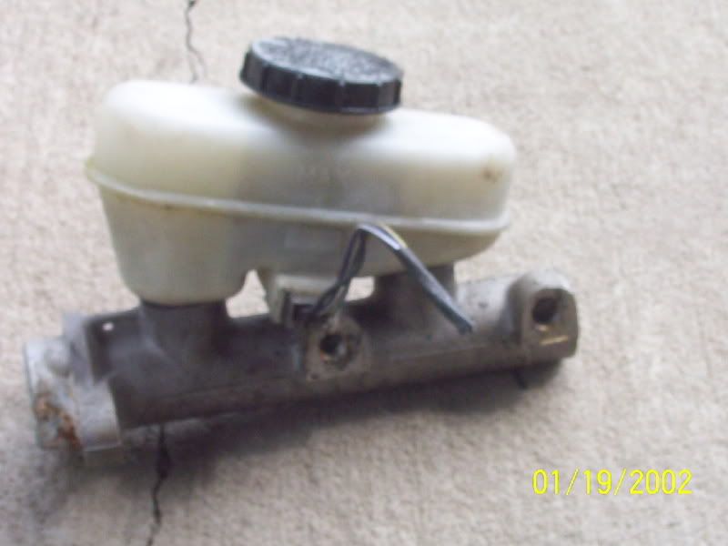

While I'm ass deep into my car at the moment, I wana try to knock out my brakes while I'm there. Here is the sit-rep:
Booster leaks air, is rusted, and has a big ass dent in the side near teh back of the head
MC leaks from the fittings after a few stops
Now the question:
I have a SN95 MC here now, and had an offer to buy a booster for $20 from the same car as the MC. I was told it will fit but is there any bennifit/loss to doing this. I'm staying stock brakes for a while so i see nothing to loose.
I'm not asking about rotors, rear end, calipers.... just the master cylinder and the booster. I know all about the 5 lug swap and thats much later down teh road. The car needs to stop before I need 5 lug.
Any input is nice
Thanks;)

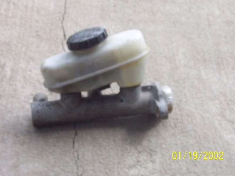

Now witha few random pics that show my current booster and MC. In one picture you can clearly see it has rust on it, and I'm not sure if you can see but all around where the MC attaches to the booster, it's wet. I assume it to be brake fluid. Hence one of the reasons I wana change to a better and working setup
P.S. these pics were taken on 2 different days
